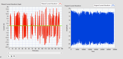

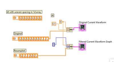

1) Can anyone please point me in the direction? For the filtered current waveform, 1D array should replace zero in the blue color. I tried for loop but it does not allow me to connect the waveform graph later.
The blue waveform has dT= 0.1 sec and the total time it should show = 3500 sec but it is showing 350000 sec.
2) How can I correct it?
Are there 3.5M elements in the data array? How many samples are there to plot?

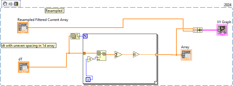

I tried to use "for loop" and use cumulative addition of array to get the time. But it did not work. This time, I used x-y graph (x-time, y data). But, time seems not coming properly.

You have two "Legacy waveforms", i.e. a cluster of t0, dt, and [y] ([Y] can be a 1D or 2D array).
You can easily create an array of those for two different plot spacings in the same graph. However the spacing for each plot must be constant.
If at least one of the plots has an uneven X spacing, all you need to do is use an xy graph.
(It is silly to show a diagram picture where most values are not even visible.)
That code makes absolutely no sense!
Typically resampling is used to turn data with uneven time spacing into data with constant dt. You seems to go the other way. What's the purpose? What are the sizes if the two arrays?

The total number of sample was 3 Million, I divided it into 4 uneven segments with different sample rate and decimate the 3M signal down to 389 sampled signal. The goal was to give user choice to choose segments and take samples as they want.
That's why dT is uneven. As those dTs are appended from the 4 segments with uneven sample rate.
You can see that X-Y curve are giving correct timing but it messes up when I use the code as subVI.
However, the Original Current Waveform should end at 3200 sec where it is showing 350000.
Your "original current waveform" contains ~3.4M samples, this gives a time of ~341k seconds with a dt of 0.1. Simple math, right?
The "filtered current waveform" has 389 samples, they give a total of 1945s with a dt of 5 - as shown in the graph…
Your FOR loop to create an array of time values is pure Rube-Goldberg (and uses wrong math). See this suggestion:
Why do you subtract 1 from the loop iterator value?
Why do you need to apply the Abs() function? (Oh, I see: there is a large negative value at the end of the dt array! Where does that value come from? Is the calculation of that array wrong, too?)
