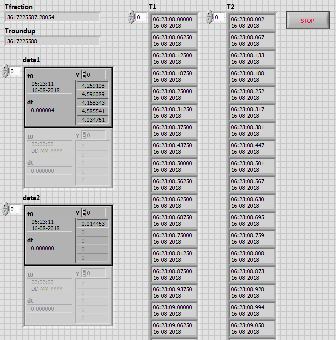

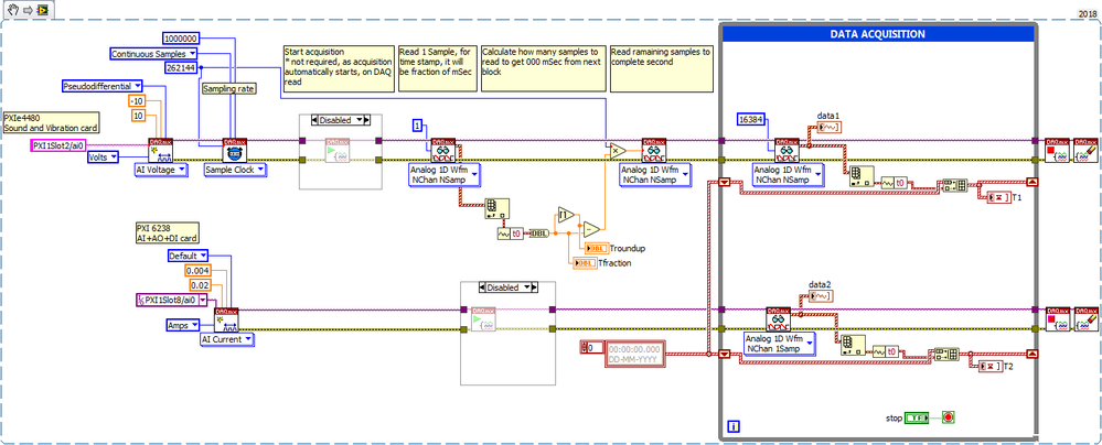

I had simplified my question. But my actual requirement is,
1) PXIe 4480 : Hydrophone is connected -- 16384 samples * 16 blocks = acquiring 262144 Samples/sec
2) PXI 6238 -- pressure sensor is connected -- 1 sample * 16 blocks = acquiring 16 Samples/sec
Vi snippet as well as VI is attached, programmed for above requirement.timeSync3.png
As you may observe in FP, there's difference of 2 to 3 mSec between T1 and T2 timestamps. And I am trying get it synchronized.

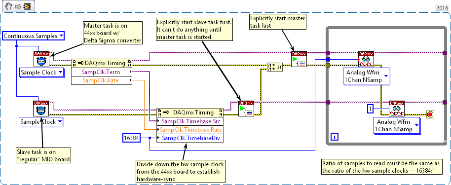

Here's an incomplete snippet to illustrate how to establish hardware-level sync based on using the 4480 board as the timing master.  Heed mcduff's advice about checking into filter delay removal.  I'm afraid I don't know exactly where to point you for those DAQmx properties though.
-Kevin P
