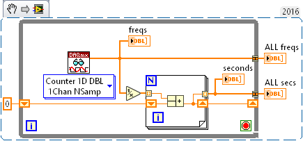

No, the DAQmx API won't do that for you.  You'll need to code it up.
Here's the basic idea to get you started -- you need to keep track of the cumulative sum of the interval times represented by each freq measurement.
-Kevin P

Thanks! I wasn't sure you could process Continuous acquisition data in the loop fast enough without causing the buffer to fill up. This is exactly what I was hoping to do.

Note: the code I posted is not a "best practice" for efficiency, just a minimal example that would be clearer than lots of words.
One important part of preventing buffer overflow is to keep the DAQ loop lean and tight.  I'm not at a LabVIEW machine now to show you code, but here's some description and search terms:
1. use a "producer consumer" approach where the only functions in the DAQ loop are DAQmx Read and an Enqueue function where you send all the data.  The DAQ loop is then the producer.  The consumer loop would Dequeue (from the same queue reference) ,then do any processing, array accumulation or display to gui indicators.
2. Specific things that aren't optimal in my earlier code (none of which would affect DAQ buffer issues after moving to the producer consumer approach above):
- concatenating arrays on the output boundary of the outer while loop.  This is probably the worst offense to efficiency.
- writing to gui indicators inside the loop.  This is a medium offense.
- doing the inner For loop processing in the same loop as DAQ.  This is probably a fairly minor offense.  (It would probably be even more minor if you specified a constant # samples to read and fed the same constant to 'N' terminal of the For loop.  This would give LabVIEW some clues that it could use to be more memory efficient and reuse the auto-indexed output array.)
-Kevin P
