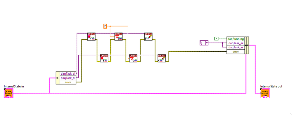

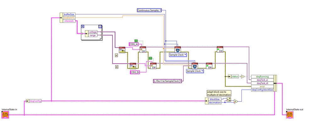

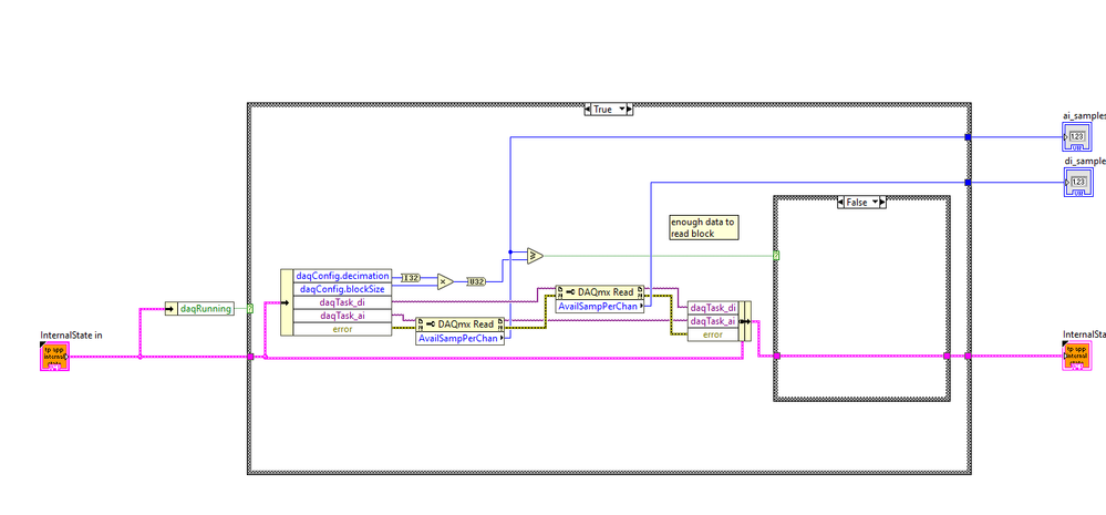

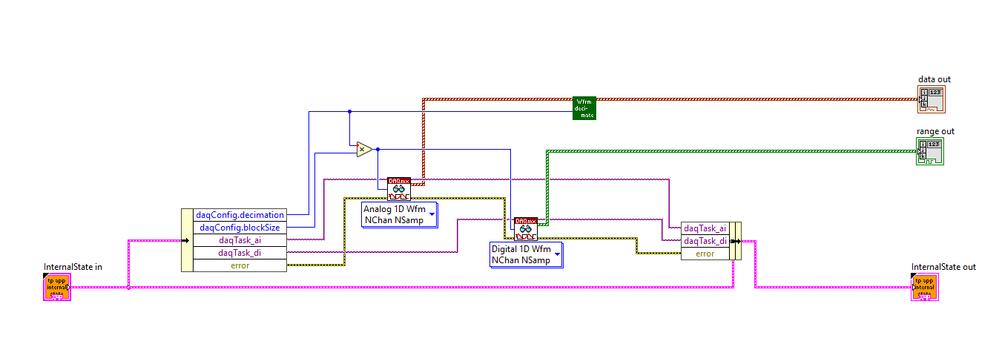

I am trying to do synchronous acquisition of several AIs and same number of DIs. AIs are gauge readings, DIs are flags indicating whether the gauge has low or high amplification. (The gauges are switching their range following the actual value, which is changing quite rapidly).
I prepared the code below; diagrams show 1) start of acquisition, 2) checking number of samples in buffers, 3) reading samples, 4) stopping the acquisition. However, it does not work: indicated number of samples in buffers remains zero (both for AIs and DIs).
The hardware is USB-6341.
What is wrong?
Thank you.
START acquisitionSTART acquisition
CHECK number of samplesCHECK number of samples
READ samplesREAD samples
STOP acquisitionSTOP acquisition

Nothing jumped out at me in the individual segments.  Are you getting an error, and if so what is the error code and description?
I'm inclined to think that your higher level code doesn't call these routines in the right order, or doesn't iterate the check-read pair soon enough after start or frequently enough while running.   That could lead to a buffer overflow error in the tasks, after which the "available samples" for the errored-out tasks will show 0.   But if this theory is right, you should be able to catch that error.
But again, the screenshots have the appearance of code that *could* work when called appropriately.  What's your sample rate?  How often do you iterate your check-read cycle? Are you getting task errors?
-Kevin P
