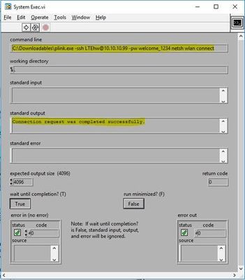

I have application, which will run commands over plink.exe using syste Exec.
We are facing below issue if we run the application on win 7.
Note: the same command works in cmd prompt on both pc win7 and win10
To show the error I have created the system exec.vi exe and executed command on both pc.
Below are the response please find snap shot.
Can you please help.
Windows 7 PC:
Windows 10 PC:

I tried up to C:\Downloadables\plink.exe without arguments it is working fine. but if i add any arguments
"C:\Downloadables\plink.exe -ssh LTEhw@10.10.10.99 -pw welcome_1234" it is giving the handle is invalid.
even in tried putting cmd /c also same error.

I can't set wait until completion to flag to false, I need the cmd processed data to perform other operations.
I think it something with labview issue.. because in cmd prompt i can able to run the same command and get response.
and in windows 10 pc the same application can able to run.

I tried with batch files also it is the same response.
