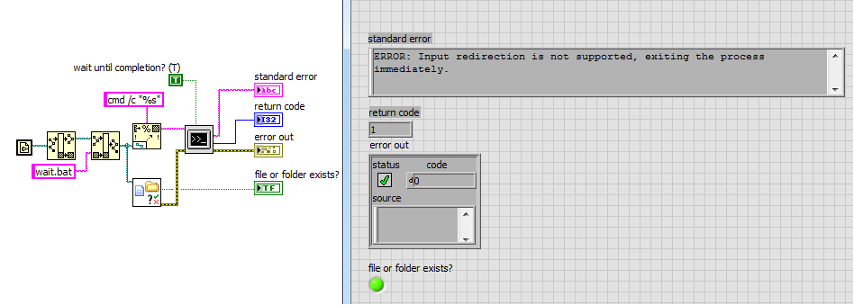

I'm using System Exec.vi to execute a simple batch file which waits 3 seconds and exits:
"timeout /t 3 /nobreak"
I set the "Wait Until Completion" flag to TRUE but the VI returns immediately if I execute it on Windows 7 64bit. On Windows 10 64bit it works correctly. Do you know what could be the issue here?
VI was developed in LabVIEW 2015 SP1 32bit. Tested with LV18 with the same results.
 *.bat extension is not allowed so I renamed the attached file extension to .txt.

I should have given more details: this batch file is not the actual file used in my app. This is just an example to simulate the execution of a batch file for 3 seconds. I need to wait until this batch file completes before I execute the rest of the code.
Standard error output is: "ERROR: Input redirection is not supported, exiting the process immediately."
Return Code = 1
Executing the batch file by double clicking on it in Windows Explorer, or by launching with Windows Run or with LabVIEW and System Exec.vi with Wait Until Completion set to FALSE, works as expected on both systems (Windows 7 and 10). If Wait Until Completion is TRUE, it does not work on Windows 7 64bit systems (tested on 4 already). Found out in the meantime that it also worked on a Windows 7 32bit computer.
@billko, I'm not sure I understood: the VI worked on your computer? If yes, what OS do you have? Did you execute the VI and saw the cmd window for 3 seconds and then VI finished execution?
Return Code = 1
