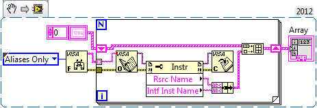

I am unable to find information regarding this "System API" that you speak of. Is this in the Instrument I/O tab in the palette?capture1.png
