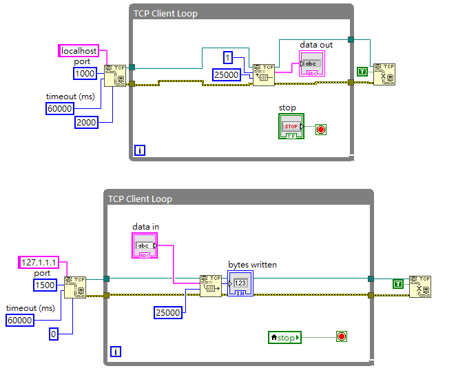

This is my TCP Client.

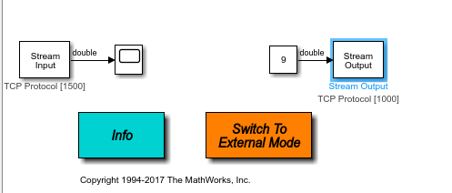

This is my Simulink TCP Server.

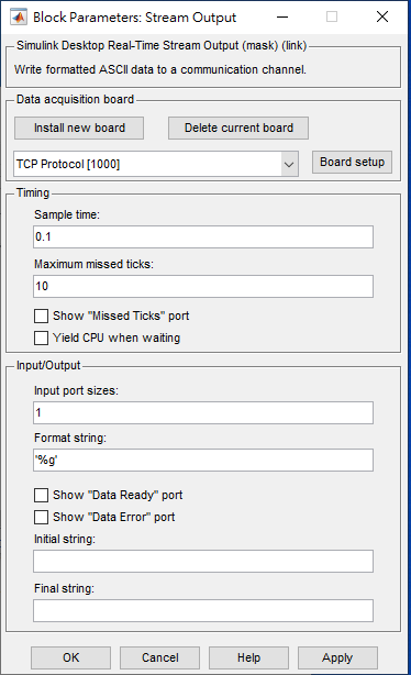

This is my Stream Output Setting.

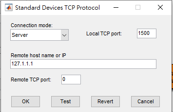

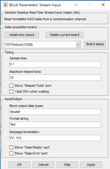

This is my Stream Input Setting.
I can send data from Simulink which the data type is double to Labview which the data type is String ,but My problem is that I can't Receive data from Labview which the data type is String to Simulink which the data type is double.

Because the Simulink is represented as double, he can read string data incorrect. If you want to receive string data from LV with numeric representation, you can use Fract/Exp String to number function, which will output double data type and will convert your string data correctly
