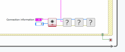

* It should also be mentioned that some of the "Database Connectivity" VI's gets a question mark if I try reopen the project after saving:

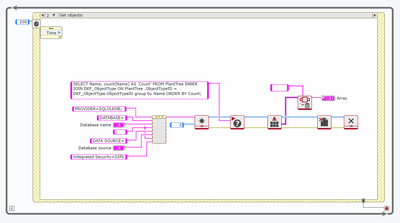

You mention recreating the project and seeing the same behavior. Can we see a reproducing case? If it's confidential, can you open a service request for the team to reproduce the problem?
Here is a snip of the VI (nothing fancy though😅)

Interesting. Thanks for that information.
I installed LabVIEW NXG 5.0 in a machine and did not see crashes when dragging the Database Connectivity VIs to a block diagram. I tried both into an empty one, as well as one with an event structure as you show in your screenshot.
