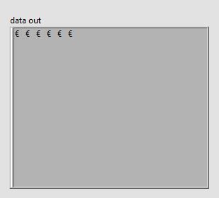

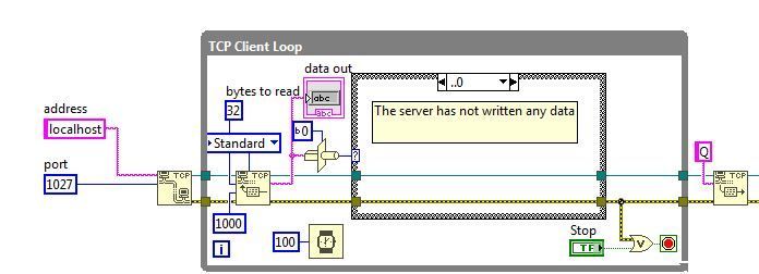

I am using a software called EddyUSB, it sends the data over Ethernet if we configure the port address, and its doing the same. But when i tries to read the data using Labview TCP/IP read pallet, its giving some junk string as "€  €   €   €   €  €  €  €" this. Is there any particular conversion i need to do or am i doing anything incorrect.1.JPG1.JPG2.JPG2.JPG

It looks like a byte-encoding problem.  Try converting the string you read into an array of U8 and see if the numbers give you (or us) a clue.  Also, why not attach the actual VI next time (so we can "play with it" without having to generate it ourselves, by hand)?

In one way or another, everything is just bits. Your "string" is just a flat collection of bytes and it will be up to your program to unflatten it according to the actual contents. Most bytes don't represent printable characters so the first thing you should do is right-click the string indiacator and switch to hex format.

If the sender is also a LabVIEW program, see how the data is sent. That should tell you all that's needed. If not, read the manual as already mentioned.

For those playing along as Hex [AC20 2000 2000.......]
Or 172 Space NUL Space NUL....
