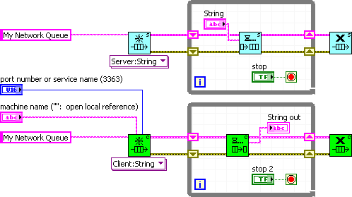

I must admit I'm a little confused by your question, but the words Network Queue reminded me that I had worked on an example library of VIs that operate almost exactly like the queue functions themselves, but that can send and receive data over the network.
You might give these a try (saved in LV2009). You simply host your queue using the Server polymorphic functions, and use the Client polymorphic functions to access them across the network. There is built-in support for three datatypes: string, variant, and object (LVOOP).
You might give these a try. It's about as simple as using named queues (hopefully 🙂 ).
