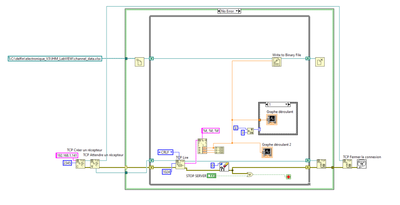

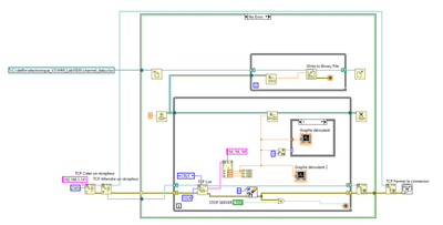

Try to avoid Express nodes. Try this change and see if it helps some. If this isn't enough, move the file write to a separate loop and send the data via a queue.
Something like this:
Qestit Systems
Certified-LabVIEW-Developer

Yamaeda, I'm not sure I fully understand what you've done...
Are you taking all the values that I'm plotting and writing them to a binary file?
Is the goal to check in the binary file whether I have all the data I need to reconstruct my signal?
Or is it for a different purpose?
Message 9 of 18
(3,290 Views)
That is not the same code as in the first message. Regarding Yamaeda's message, he replaced the express VI that you used to log data to an excel file which is extremely slow. Did you attach the right code?
