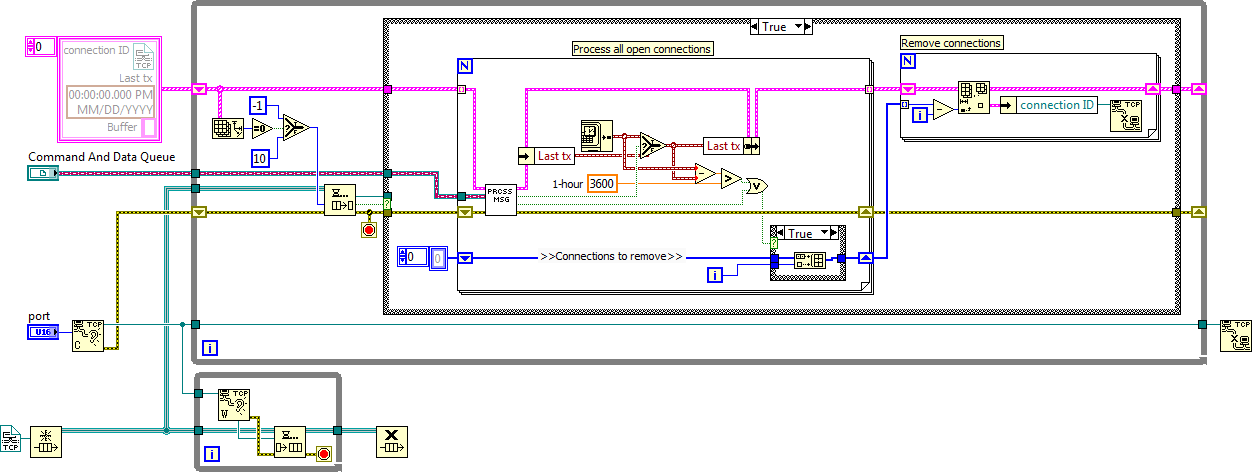

I'm not sure what your overall goal is here. Usually what I've done, in a situation with a single server and multiple clients, is a dedicated loop that waits for new connections (using Wait on Listener). When a new connection is established, the new connection reference is put in a queue, where it is retrieved by a second loop. That loop maintains an array of all active connections along with the time that data was last received on each connection, and continuously loops through all open connections looking for new data. This is one way to handle multiple connections; another one is to launch a new copy of a re-entrant VI for each new connection. I posted an image of my usual approach here:
In your case, if you want to track IP addresses, you could add that to the cluster that contains the time stamp, and then when new data arrives on a particular connection you can associate it with the corresponding IP address.
