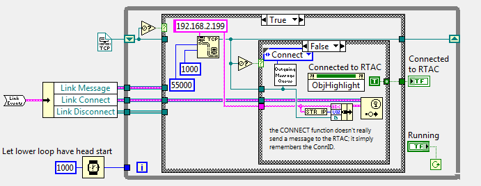

Well, I thought I knew all there is to know about TCP connections - I’ve been using them for years, but I have found a new wrinkle.
I’m using a pattern I’ve used before, except this time I’m trying to automatically re-establish a broken connection:
ConnID = NaN
repeat
    if ConnID = NaN        // if there is no connection...
        ConnID = TCP OPEN CONNECTION (Address, Port, Timeout = 1000)
        if ConnID = NaN    // could not connect
            Flag = FALSE    // make sure light is off
        else
            Issue CONNECT event (Conn ID) // internal event
            CONNECTED LIGHT. ObjHighlight ( ); // draw attention to the change in status
            Flag = TRUE   // make sure light is on

The pattern worked fine, without the ObjHighlight( ), for quite a while.
I decided I wanted to draw user attention to the fact that the connection was made, so I inserted the ObjHighlight( ) where the connection was first made.
That works fine. Regardless of whether the host (this code) or the other end starts first, this code makes the connection, and now highlights the light when connecting.
But what I don’t understand is that the highlight ALSO happens when the other end BREAKS the connection.
If I kill the other end, then the light highlights, and then is OFF.
I have verified that there is one and only one ObjHighlight( ) node, and that it is indeed where I have listed it above.  A breakpoint verifies that it is indeed called when the connection is BROKEN.
The RECEIVE MESSAGE subVI waits on a message on the given ConnID, and turns an error into a DISCONNECT command. It also sets the ConnID to NaN, in case of error.

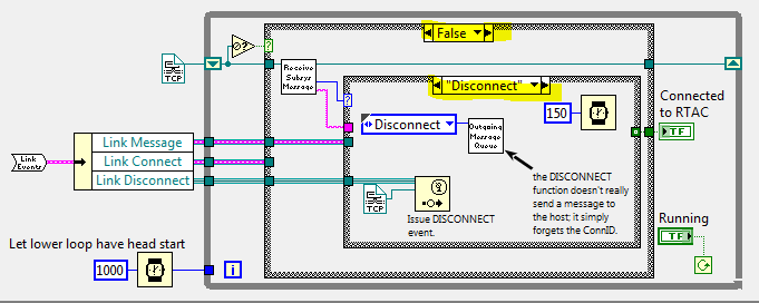

Now if I use the WAIT function with N = 0..125, nothing changes.
But if N = 150 or more, it does not exhibit this behavior.  The light does NOT highlight when the connection is broken.
I can infer from that, that the system on the other end hasn’t fully reacted to the ABORT and still has the “ringer turned on” so that it can still hear an incoming call.
Somewhere between 125 and 150 mSec, it gets around to shutting off the ringer and all behaves as expected.
Oddly enough, if i insert an ObjHighlight( ) call in the DISCONNECT case, that serves to delay things enough to where it works right, but I don't want to depend on that.
