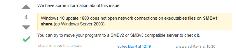

I found this more direct answer to the question about running exe files on smb v1 share.Smiley Sad
https://stackoverflow.com/questions/50155482/after-windows-10-update-1803-my-program-cant-open-a-soc...

The problem, as shown by Ola_A, is that the latest Windows 10 version does not allow a process to use Winsock, if it was started from an SMB v1 share. Solution is to either install the executable locally and run it from there, or to reconfigure the server computer hosting the share to use SMB v2 instead.
