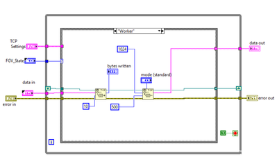

I'm actually working on a project, where Ouster lidar sensor is my server and I need to communicate with it using TCP protocol. I used multiple examples to implement it (screen short attached).
the problem is I'm  accessing the TCP port (7501) of the sensor  but I'm not receiving any packets from the sensor. While using ouster SDK I'm able to receive the TCP packets using Wireshark  (screen short attached).
I also tried and tested my labview program on TCPclientServer application, it works. as well as i tried to access the ouster via netcat it is also working (snapshot attached) .

Is there any way you can attach your VI?
I know you are using or trying to use state machine. I want to see how you are transitioning from state to state. So attaching your VI would help.
(2,079 Views)
Accepted by topic author imkakakhel
Thank you for the response, The issue has been resolved. The sensor was not able to understand the command. by adding format into string function it worked.
