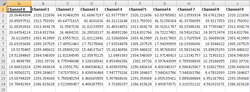

  1. Don't use that Transpose 2D array, it doesn't solve your problem.
  2. Write the "normalized" data to different channels, you get all the data just appears in one single column because you write all the “normalized” data to one single channel repeatedly, thus they'll appear in one column(channel).
  3. Several cells containing zeros is because float64 y1[30] array in your normalising equation, you need remove the zero elements from y1[30] before writing to file.
I attached the modified normalising program.vi, hope this can do some help to your problem.
The snapshot below shows the data in Excel after "normalising" equation, the channel data appears in columns.
