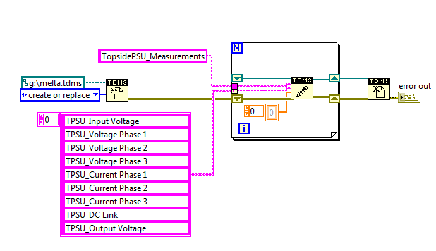

I think all the channels of group TopsidePSU_Measurements from your attached file are never written with raw data, or explicitily written with zero length raw data. That's the key of the crash issue.
The crash is not relative with OS or file size. In LabVIEW 2015, TDMS Defragment function cannot defragment a .tdms file including channels with 0xFFFFFFFF raw data index. That kind of channel not has NI_ChannelLength property when you use TDMS Data Viewer to watch it. All the channels of group TopsidePSU_Measurements have 0xFFFFFFFF raw data index. Thus LabVIEW 2015 crashes during TDMS Defragment. We will improvement TDMS Defragment function.
From your side, I can provide a workaround.:
1. Write zero length raw data for these channels under the identical group in a new .tdms file, as following.
2. Copy the binary of the new .tdms file at the beginning of your attached file. Then you can successfully call TDMS Defragment function in LabVIEW 2015.
The modified file is attached below.
Hope this will help.
Jie
NI R&D

Thanks for investigating this, I really appreciate it 🙂 I can confirm that this also happens using LV2015 on a win7 machine. LV2014 works however.
Yes, there are several channels/groups that does not have any data stored to them (yet). This was not a problem in LV2014, so never thought of writing empty data to them. Would writing the NI_ChannelLength to 0 at initialization of the program making the TDMS files do the same trick (for new files)?
Another workaround for the already logged files is to defragment them using LV2014.
I think we are closing in on an explanation of the problem. It does not, however, explain why it works fine on a 80MB file which also has the channels/groups with no data? Any suggestions?
Øyvind
