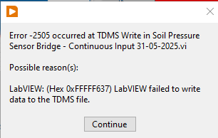

Eight years and 10 versions later the same errors persist!
Message 8 of 8
