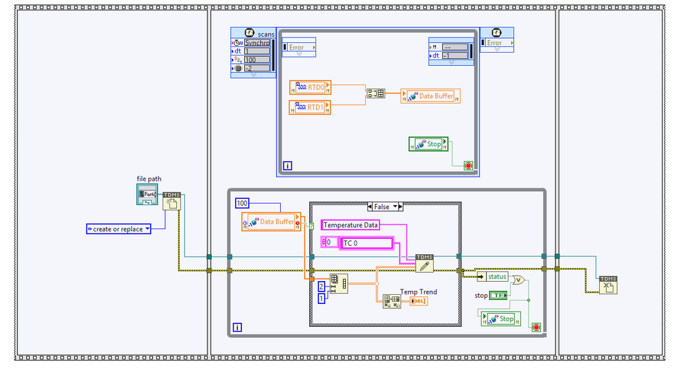

I am trying to save a TDMS file using a Crio on a lab view software. The code runs successfully but i am not able to find the TDMS document on my computer? any suggestions?
Please find the attached blocked diagram.

That is because a cRIO is NOT part of your computer.  You have to treat it as another computer.  You need to set up a network communication between your cRIO and your computer so that the cRIO sends your computer the data and then your computer logs the data.  I highly recommend Network Streams for this.

Thanks for the suggestion, actually I am new to this and have been using from 3 days, if possible could you please explain the steps a bit more? Thanks

NI LabVIEW for CompactRIO Developer's Guide

Hi, if i connect a USB to Crio will I be able to retrieve the file then?

That will work as well.  It should show up as /U

Tried that, still the file does not show up.

So what is your file path?
Have you tried to browse the cRIO folders?
How do you know it is not logging to a file on the cRIO?

I have tried plugging in the USB to Crio which shows up as drive U and I tried to save the TDMS to the file path as:  /U/TDMS/tdms
When I start looking for a file I can't find it there.

And what does you error cluster on the TDMS open say?
