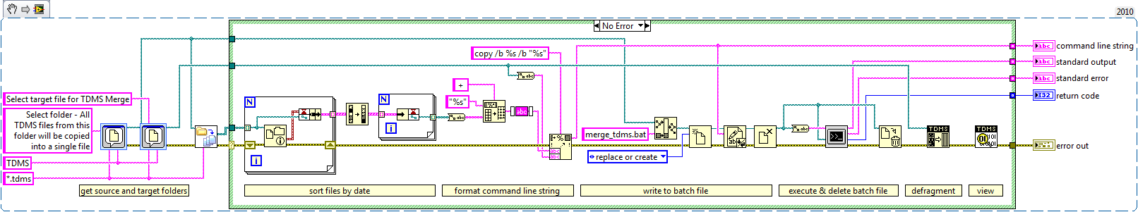

Also, it appears that the "mergeTDMSfiles" vi will not work for very large files, since the build array function is memory resident.   Any way to get around this?
Hope this helps:
Hope this helps:
