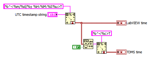

I don't think this is an Excel issue, but rather a TDMS issue - while LV keeps track of both UTC and the local offset, TDMS just stores the UTC information.  I understand that you wouldn't want to figure the offset when you import the tdms file because the file write and file import don't necessarily happen in the same place.
So wouldn't it make sense to store the writing machine's local offset in the tdms file and calculate local time on import?  Alternatively, give me the option of saving it with the offset built in.
I didn't like having to do this:
