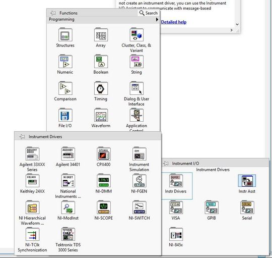

Hi PFour,
I have just downloaded the driver from here: https://www.aimtti.com/resources/cpx-series-power-supplies-combined-labview-driver-and-labwindows-cv...
When you unzip and run the setup.exe from the folder it will run you through an installation of the drivers. This will be saved to this location:
C:\Program Files (x86)\National Instruments\LabVIEW 2017\instr.lib
However, if you completely close and re-open LabVIEW (I am using 2017) and go to the functions pallette as shown in the image below:
I hope this helps.
Kind Regards,
Matthew Fergusson
Applications Engineering UK
