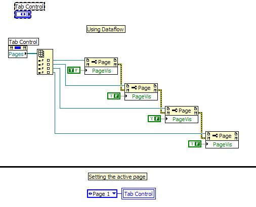

The order of the property nodes is not defined because you have no dataflow between. Execution order is not defined by where a function is on the block diagram (left, right, top bottom), but how data is connected. You have no connections between the properties so they execute in parallel and you have no way of knowing which one will actually execute first. The simplest way to enforce dataflow is with the error in/error out connections. That is shown below. also shown is one way to select the active page. I used a local variable but if you make the tab control an indicator instead of the default control, just wire a value to the terminal itself.

You (Vcteo, not Dennis) should really run the original VI with the highlight execution (little light bulb) on. And then Dessis's VI. This will illustrate that the order of execution is completely arbitrairy, unless you force it.
Since this is the essence of LabVIEW, you'll have to understand this to succeed.
Wiebe.
