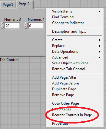

I have been able to find Reorder Controls in Page in LabVIEW 8 on a specific tab page by right-clicking on it's edge. You need to have more than one control on the page for the menu option to show up (ie. it is not there if there is one or no controls on the specific page you are trying to rearrange):

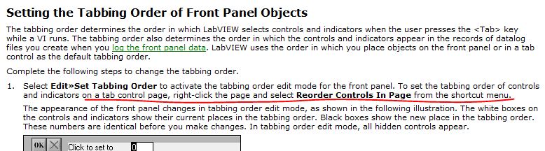

Yes! The way the help document is worded it makes it seem that you right click on the tab control while you are in the Edit > Set Tabbing Order menu. But you actually right click during normal VI editing.
