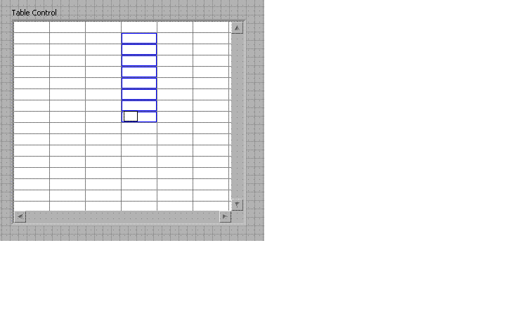

When the table front panel is open I can click and drag the cursor to select a contiguous region (outlined in blue)
Is it possible to recognize the selection so I can change the properties of just the few cells I have selected?

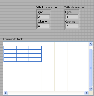

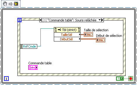

Hi, it's easy : when the mouse is released, you can check which part of the table is selected, and the begining of the selection :
17763iF06797795B9E05E417765i721F64FDD39E70DC
I joined the VI in Labview 2009.
