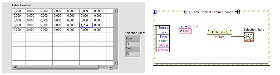

Your right, "edit position" gives you the position where your are currently editing a cell. As soon as you hit "retrun" or "tab" the new "edit position" is one row respectively one column further.
I used a event structure and the selection start property to find the "real" edited/changed position, as follows:
Let me know if this helps you.

Thanks for answer. I have found another solution. Selection Start shows only if I select the cells with mouse.
My solution is:
