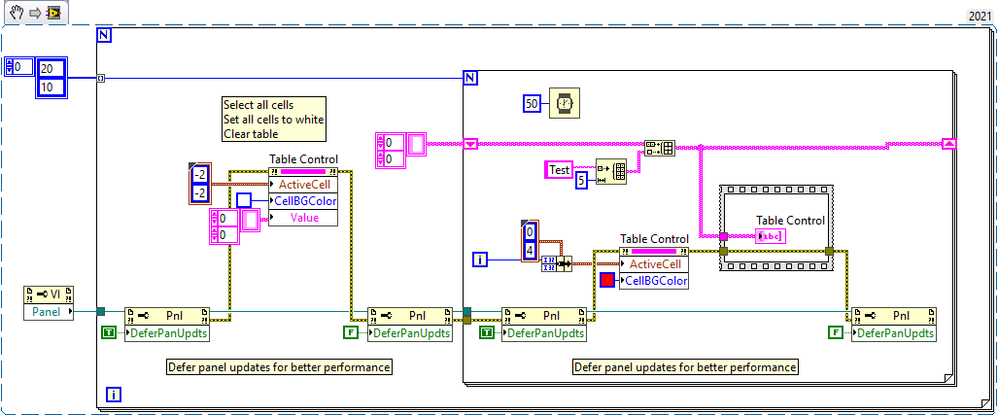

Just use the -2,-2 as ActiveCell and set the CellBGColor to white when you clear the table.

Check out the documentation for "Active Cell": https://labviewwiki.org/wiki/Table_class/Active_Cell.Active_Cell_property
The magic indices "-1" and "-2" set properties for the heading cell and the whole column/row/table. In case you've been using them: The german help files contain translation errors ("size" instead of "position"), so refer to the english help.
The cell height auto size is a bit wonky. (I see you already found the solution to that one.)
