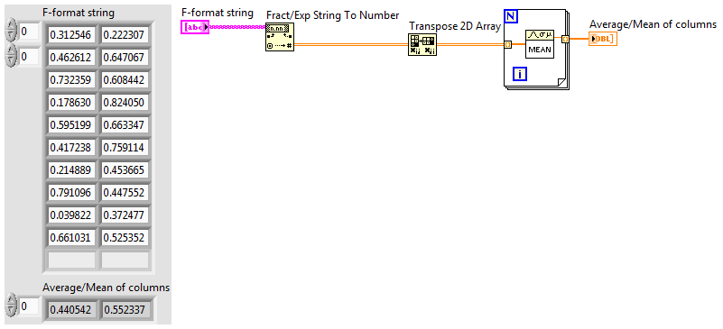

I can connect it directly, but i need to know how to take value from exact colum and make calculations with it(average value from all colums, devation and same...).

Hi Nenoo,
to "take values from table" you need to index array elements. Usually IndexArray is the function you need.
(Or autoindexing in a loop, depending on your task which isn't defined very well until now.)
here's one part (average) for you....
