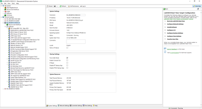

However, when i'm going into the VI the channels are not well configured and i have no chance of setting the outputs like the video is showing because i can't install DAQmx add-ons in cRIO.
Someone have an idea why this is happening?
This is the software installed (in MAX):

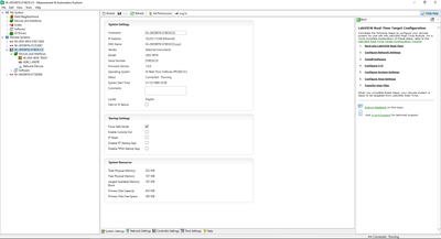

This is the Devices and Interfaces (in MAX):
I have LV2019 and DAQmx 2019 installed via NI Package Manager.

that is quite an old cRIO you have there, running VxWorks as OS and a 400 Mhz Power PC CPU. This is not compatible with DAQmx.
Compare this KB
DAQmx is a relatively new feature on compactRIOs.
Regards, Jens
