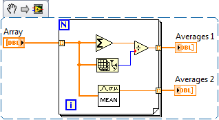

Averaging rows is very easy with an auto-indexed For Loop. If you build your array into rows, the example below will work. If you build them into columns, then you simply have to transpose the array before connecting it to the For Loop. The attached example does this two different ways and achieves the same result.
-Zach
