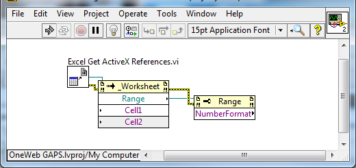

It doesn't exist, you will have to create it. Use Excel Get ActiveX References.vi and do something like this (incomplete).
ScreenShot008.pngBen64
