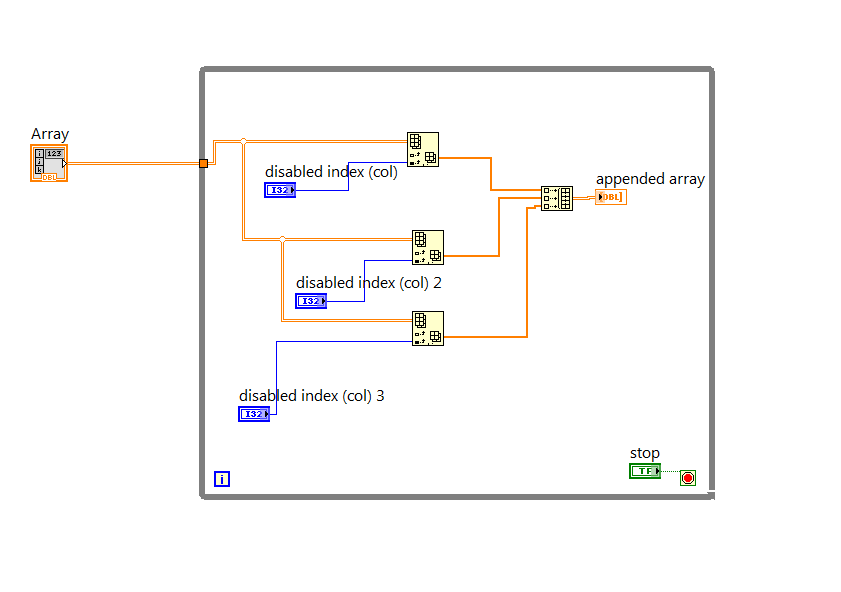

How can i extract different column (combinations) from an array.
I would like to have a 3 boolean array and would like to extract column 1 and 3  by pressing boolean 1 and 3 to ON state.

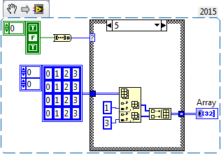

You can do something like this. Use boolean array to number to select different cases.array selection.png
edit:

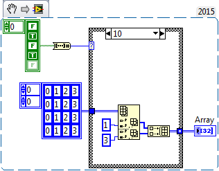

didnt want to confuse you with array selection, changed the booleon array.  Arrays start at 0 so if you wanted 1 and 3 it would look like this.
-Matt

Thank you so much. It works great apart from the fact that i have to create 8 cases, which would be a problem if the size of my boolean array increases?
Is there a solution for that?
Thanks again

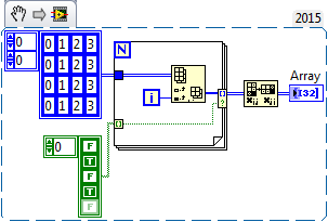

I guess conditional autoindexing has been made exactly for this purpose... No case, no build array, no shift register. My 2011 can not make them, so I can not show...
Message 6 of 8
(5,904 Views)
Accepted by topic author zezendapuss
Very true,
Here is a cleaner example using alexander's suggestion, if you have the conditional tunnel mode available.
-Matt
