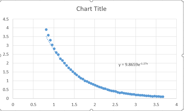

I have data as shown below.
I would like to use Labview to get the tangent in the point where Y =2.

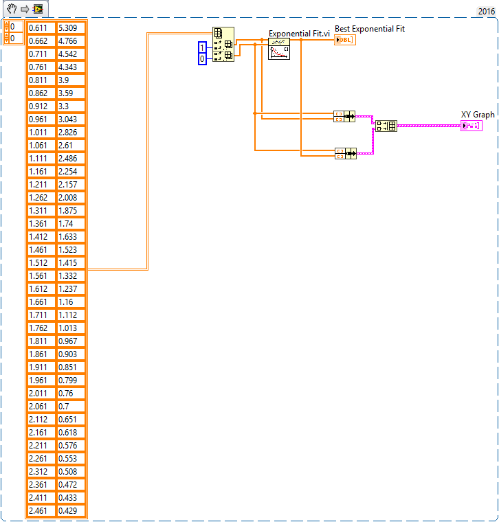

Actually, the only data I’m interested in, is the slope of the tangent in this point.
In order to get the fit, I used exponential fit, hoping I would get the expression of the curve as I did it in the in excel (image).
The derivation function you talked about, where do I find it, and how to use it?

The exponential fit outputs the "amplitude" and "damping" (and "offset", but you currently force the offset to be zero). These are the two parameters that define the best fit and you can analytically calculate the derivative instantly for any desired X. This is the correct way.
(Doing numerical methods, such as the mentioned derivative function will not give you anything accurate)

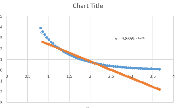

Hi Blokk
Thank you for your very fine explanation
Using your calculation of the tangent seems to give at wrong result ?
Are you sure the derivative is correct ?
I get the derivative: a*b*exp(b*x). Don’t know if that correct?

That is correct, the division was my mistake. When you derivate this, you need to multiply with the derivative of the internal function.
