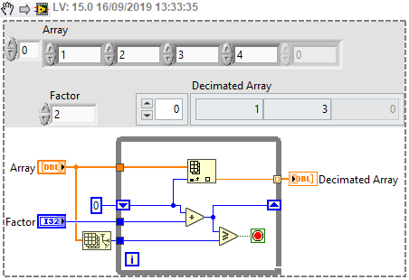

1. Producer/Consumer sounds good for this situation. Take care to correctly handle the ends of your loops (Bob_Schor might advocate Channel Wires rather than Queues for this purpose!) Ensure that you're sending blocks of data (not 1 point at a time) and when you display on a graph, you can choose to decimate the array of points if the numbers are far too large. Unfortunately "Decimate 1D Array" doesn't really do this in the way that you'd want, so consider a subVI with something like this:
Depending on your decimation factor, Quotient and Remainder, Index Array or Reshape Array followed by Indexing a row/column might be faster. I tested it in the past but forgot the results!

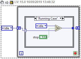

It seems like you want the "standard waveform" section to behave like the "User Profile" section in some ways... Perhaps you can simplify the logging by ensuring that they run through the same case. You could do this by loading data into the Shift Register at the bottom based on the Function Generator output using a "Load Standard Profile" button, then using the same (now double used) "Run (loaded/generated) Profile" which runs whatever is visible in the "Loaded Profile" display.
To run indefinitely, you'd need to be able to either loop (assuming you know you generated an integer number of periods of waveform) or continue to generate. The first can probably be accomplished by switching to Continuous Samples with "Regeneration":
This is a DAQmx Write property node - you'd need to execute it for both DO and AO if you wanted both to repeat. It's also not available on all hardware, and can have limited buffer space. I haven't checked if your hardware will support your typical waveform lengths... sorry!
The second is a bit trickier because you'll need to keep calling Write.vi as needed to add more samples to the buffer, and generate them continuously. A separate state with "repeatedly buffering" or something might work for you here. You'll need to pass the task references into that state to be able to repeatedly call Write, along with information about the waveform to be generated. You can exit the case with something like the following:
Using a Select node to choose between cases.Using a Select node to choose between cases.
You could hide or show this button by manipulating the Visibility setting under the Property Node for that control.
