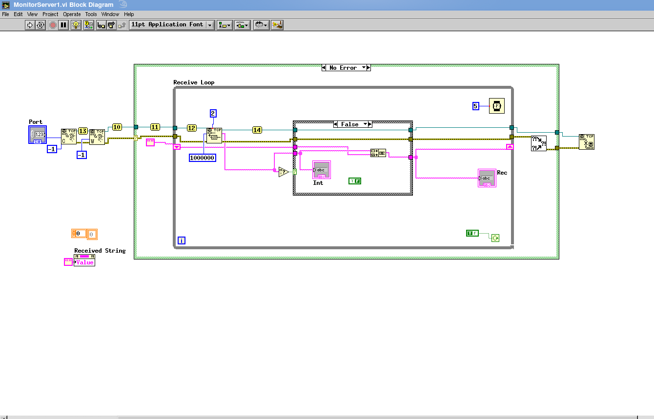

I am getting Error 1 at TCP read. I am getting this error since I created a TCP listener. My Vi worked fine when I didnt have the TCP listner i.e just had the TCP open instead of the listner. On checking, the Connection Id is same at probes 10, 11, 12, 13, 14
Attached is the vi. Please help.

Error 1 most likely occurs when you try to open the port simultanously in multiple location.Also have you verified the posrt number?

It seems you're wiring the listener ID to TCP read. You need to wire the connection ID which you get from the wait on listener.
