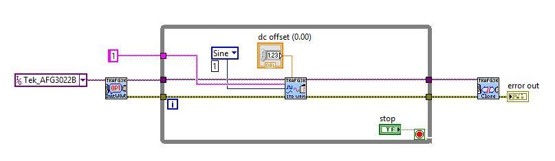

I want to be able to change a parameter of the output (say, the signal DC offset) dynamically, inside a while loop. The simplest approach doesn't work at all:
Doesn't work > clicking sound > nothing changesDoesn't work > clicking sound > nothing changes
When the "dc offset" is changed in the front end, a clicking sound is continuously produced by the instrument (as if it is constantly resetting), but nothing else happens.
[Note: Outside the loop this works, i.e. by using a constant instead of a knob for the dc offset. Also, the clicking stops when I return the dc offset to 0].

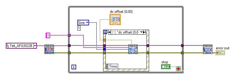

So, I used an event structure:
This works, but resets the device every time!This works, but resets the device every time!
Now, this works, but whenever I change the value of the dc offset, the instrument momentarily resets (with the characteristic clicking sound), before applying the changes. This, apart from being annoying and potentially harmful for the device, is not tolerable in my experiment for a variety of reasons: I can't have voltages resetting all the time, as this screws up the measurements, and the time it takes (~1s) is just too long.

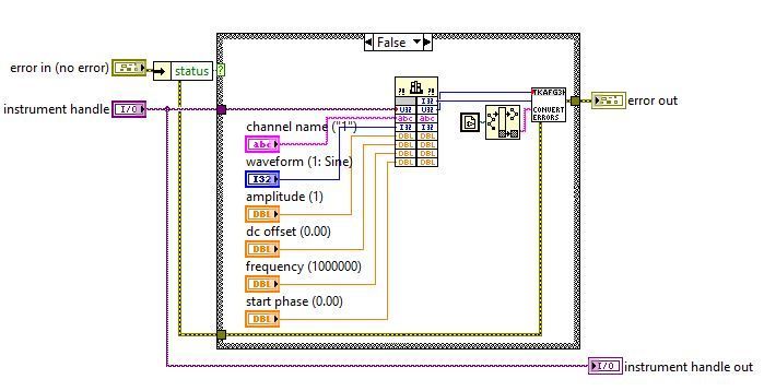

Dwelling just one level deeper, I see that the VI I'm using inside the event structure, the "tkafg3k Configure Standard Waveform.vi" is just a function call to the driver DLL:
tkafg3k Configure Standard Waveform.vitkafg3k Configure Standard Waveform.vi
So, there doesn't seem there's much I can do! Can this really be the case? Could there be any possible workaround?
