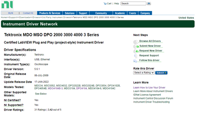

The scope initialize VI doesn't recognize the scope model which is "DPO_SCOPE_4104B". Is there an updated VI?
(1,517 Views)
Which driver are you using? This one says it supports DPO 4104 (tested) and DPO 4104B (not tested).
http://sine.ni.com/apps/utf8/niid_web_display.download_page?p_id_guid=6E23DB10D9FC2B05E04400144FB7D2...
(1,508 Views)
(1,403 Views)
Don't be afraid to fix a broken "driver".
Most Instrument drivers packages "Initialize" vi simply does an IEEE 488.2 common command "*IDN?" query to check if the right instrument is present.
There is nothing special about a *IDN? querry and most modern instruments will respond with their make, model, serial number, and possibly even a firmware version.
An older version of the driver may not have the newer model number in the VI.
Jusd open the Initialize VI block diagram and add it.
