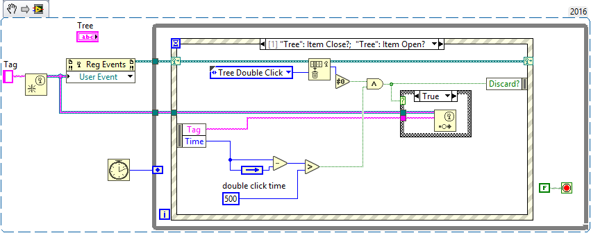

This was a bit of a pain but I think I've got it, and you don't need to worry about pixel counts. Hopefully there aren't some edge cases I haven't considered... but the example works 🙂
I think this'll do it:
I tested the different events generated by both actions (double clicking an item versus an Expansion box), and noted the following:
-Double clicking the item name generates an O/C (Open or Close) event and a Tree Double Click event nearly simultaneously
-Double clicking the Expand button generates an O/C event immediately, and another O/C and Tree Double Click event about 150 ms later (the length of time between two clicks).
We therefore have 4 cases we need to handle with 4 different "event signatures":
-Case A: The user double clicks the Expand button. The list should rapidly expand and contract, and generate no popups. Events generated are an O/C event, then ~150 ms later, another O/C event and a Tree Double Click event simultaneously.
-Case B: The user double clicks a parent name. The list should not expand or contract, and a popup should show for the Parent item. Events generated are an OC event and a Tree Double Click event generated simultaneously.
-Case C: The user single clicks the Expand button. The menu should expand. Events generated are an OC event.
-Case 😧 The user double clicks a Child name. Only a Tree Double Click event is generated.
The key is the simultaneously generated events. During each O/C event, use a Flush Events function set to Tree Double Clicks. If any events are flushed, we know it was a simultaneous event, so we know we're in Case A or B. If no events are flushed, it was a regular Expand operation, so we're in Case C. Last, case D is handled with a regular Tree Double Click case.
A and B are discerned by the time since the last O/C event (note the use of a Feedback node, not a shift register, since we care only about the time since the last O/C event- not the last event.) If the time since the last O/C event is less than 500 ms (what Google says is a double-click), then we're in Case A, otherwise we're in Case B.
I hope that makes sense- my test code seems to work, hopefully there aren't any Gotchas when you put it into real use.
Edit: Forgot to mention one thing. The name of the User Event is important. If it's not Tag, then the Event Structure won't be able to give you any data in the Tree Double Click case, and you won't know *which* parent item was double clicked.
Message 7 of 15
(7,903 Views)
