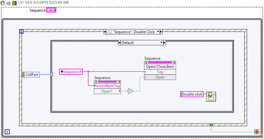

Thanks for the tip, that does help but adds another issue that I have a solution for.  If I double click a parent item, I can use the CellPart to tell me what part was double clicked and if it was the Open/Close Symbol to do nothing.
The only problem I see is that the the Expand/Colapse event is triggered before the double click event.  So I don't have a way of knowing if the Expand/Collapse should be discarded until after the event has taken place.  So what this means is you'll double click a parent item, and it will Close or Open, and then the dialog comes up.  The only solution I came up with so far is to read the state of the Close/Expand and invert it after a double click.This causes a slight blip in a quick close and open on the UI if you double click a parent but I'm okay with it since the code is much simpler.

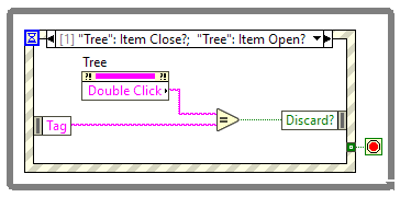

I found this thread as I was trying to figure out how to disable the double-click to expand/collapse functionality in a Tree Control. I still want users to be able to click the expand/collapse symbols, but I don't want to expand/collapse if they double-click anywhere in the tree.
I ultimately stumbled upon this really simple solution that I thought I would describe here, as I didn't see anyone else mention it. The Double Click method of the TreeControl class gives you the tag of the last item that was double-clicked:
This essentially gives us the information from the 'Double Click' event while we're in the Item Open?/Item Close? filter event, so we can know if the Item Open/Close was fired as the result of a double-click. If it was, I can simply discard the event (so the item isn't opened/closed, and then immediately after this diagram executes, the Double Click event fires). I tested it quite a bit and it looks like the method is pretty good about not giving back stale data, i.e. tags that were double-clicked previously before an Item Open/Close happens.

Darren's solution works well except for when the user is clicking directly on the expand/collapse symbol rapidly.
This produces a "double click" event, when the user was really just trying to expand/collapse the tree rapidly.
Pretty niche, but also noticeable and undesirable.

That could be addressed at the OS level by adjusting the speed of the double click (in the Mouse settings)
