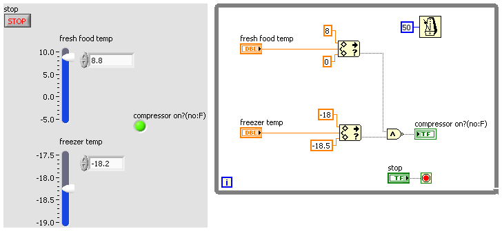

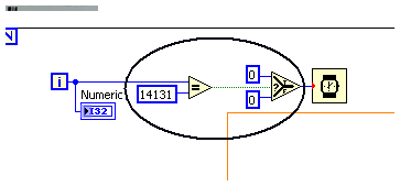

you mean something like this?
Spoiler
and this does not make any sense?
Spoiler

Are you kidding? It works continuously, without shutdown...
edit: I was checking some values for desired times in the program when I need I use it. I know it seems meaningless in this way...
Egemen
Message 7 of 17
(6,082 Views)
your compressor is going to work until the set temperatures are reached...is that not what you had stated in the 1 post? those controls are connected to your acquisition...
