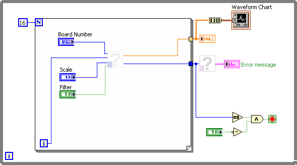

You didn't include the subVIs TIn or ERRMSG. Where did you get this example? Is it for use with an NI data acquisition board or something else? From the simple example (and hideously colored, btw), it looks like you are only taking a measurement from one channel at a time so you are doing a scan at all. I would suggest as a simple fix that you replace the while loop with a for loop and wire the channel input to the iteration terminal to scan through the channels. Autoindedthe results and use an Array to Cluster function (set for 16 elements) and wire that to a chart instead of a graph. A chart is designed to display data as it is acquired. something like the attached.

I don't see anything in the posted LabVIEW programs that would cause this. I don't know anything about measurement & computing hardware but an open channel should not cause all channels to fail. You have again failed to attach the subVIs that do the actual scan TIScan or TIn so it is possible that there is something in there. A DAQ board measures voltage and in order to get temp readings, the voltage measured must be scaled. If the scaling is done in the missing VIs, then you should post them. If you run TIn on a good channel with a different one that is bad, do you get a correct reading? If you do, then I would suspect some code problem in the TIScan. The code I posted should allow you to use TIn to take a measurement on all channels.

The code you provided worked great. I finally had a chance to work with it. I believe as you mentioned  there maybe a problem with TinScan.

To control the time between channels, you would put a Wait (ms) or Wait Until Next ms Multiple inside the for loop. To control the time between complete scans, put one or the other outside the for loop but inside the while loop. If you want the chart to display the actual time of acquisition, then you have to change the x scale properties and write the start time and loop interval to a chart property node. There is a shipping example called Real time Chart that shows you how to do that.
