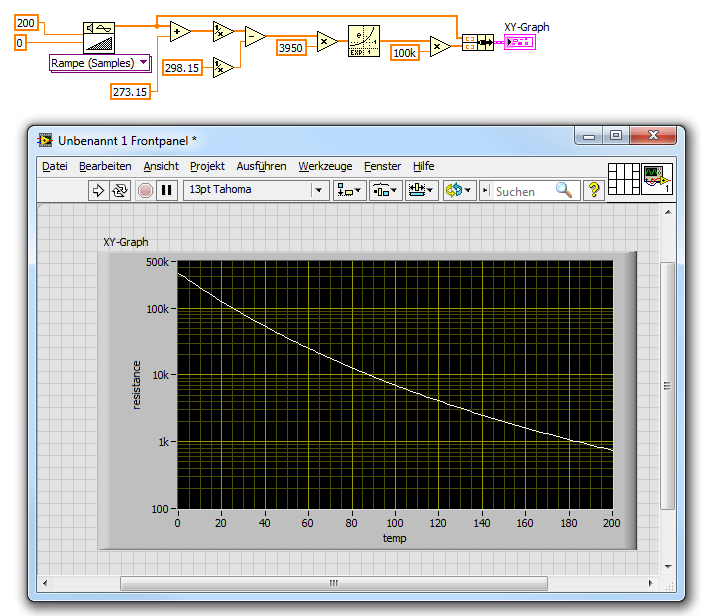

Hi Amanullah,
plot the resistance vs. temperature curve for your thermistor. Then calculate the voltage you will read when using a voltage divider with some pull-up resistor. Then decide on your own if the voltage changes are still ok to build up a temperature control for T>100°C…
I made an example for you:
You can use Excel too, but as we are in a LabVIEW forum I used LabVIEW…
From 25°C to 100°C resistance changes from 100kOhm to ~7kOhm, but from 130°C to 200°C the resitance change is quite small with 3kOhm to 0.8kOhm…
