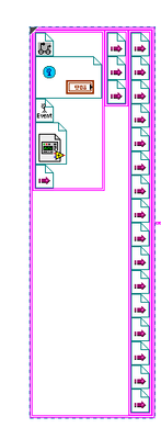

i’m tryng to develop a vi for managing more automatic repetition of a TS sequence, I’m started reading the following article: https://www.ni.com/en/support/documentation/supplemental/14/working-with-the-teststand-simple-user-i.... Since there are too much [link here] without a link to consider a full explanation about the matter, I have decided to analyse the VI example. The first thing I have opened was the cluster (visible in the second figure), except for the element that I have found, all the other Reference that was create, where I can find them? Are there any other papers that I can read for improve my little knowledge?

Most of the reference are ActiveX reference of buttons, Combobox...
To create a constant in the cluster, first find the terminal of the ActiveX ctrl, on the right click menu, choose Create => Constant.
right click the wire, on the popup menu,
