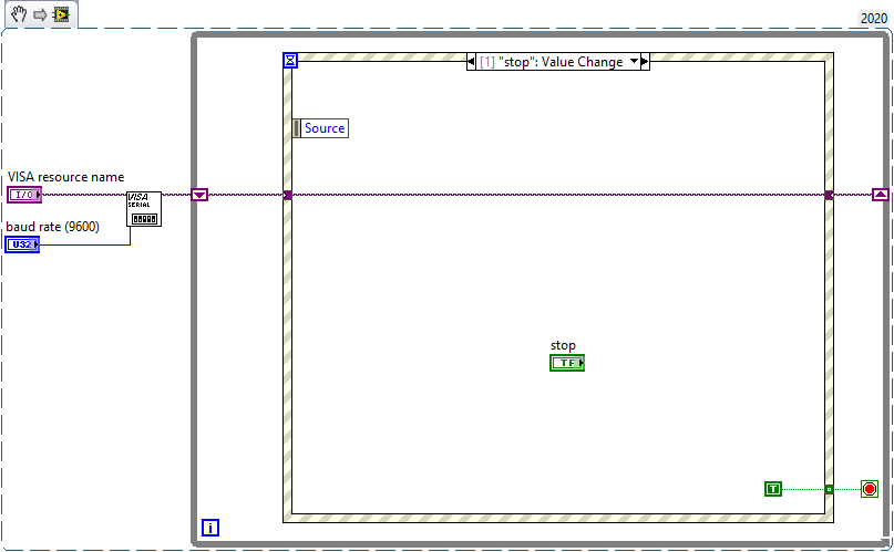

The state of that code... I would keep it as reference, but trying to fix it is probably more effort than starting new. I would just take one of those case structures and get it into a new vi with a while loop and event structure.
Start with this, once you learn how the event structure works build out from there.

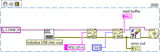

Start simple. Copy the visa configure code and something simple like the "stop" command "WSL 0<LF>". Do a visa write with "WSL 0<LF>" and a visa read after and see if you get any data back.
