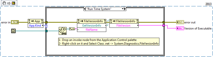

Without a toolkit you can do it like this (I would guess the toolkit vi is a wrap up of something similar).
Ben64
