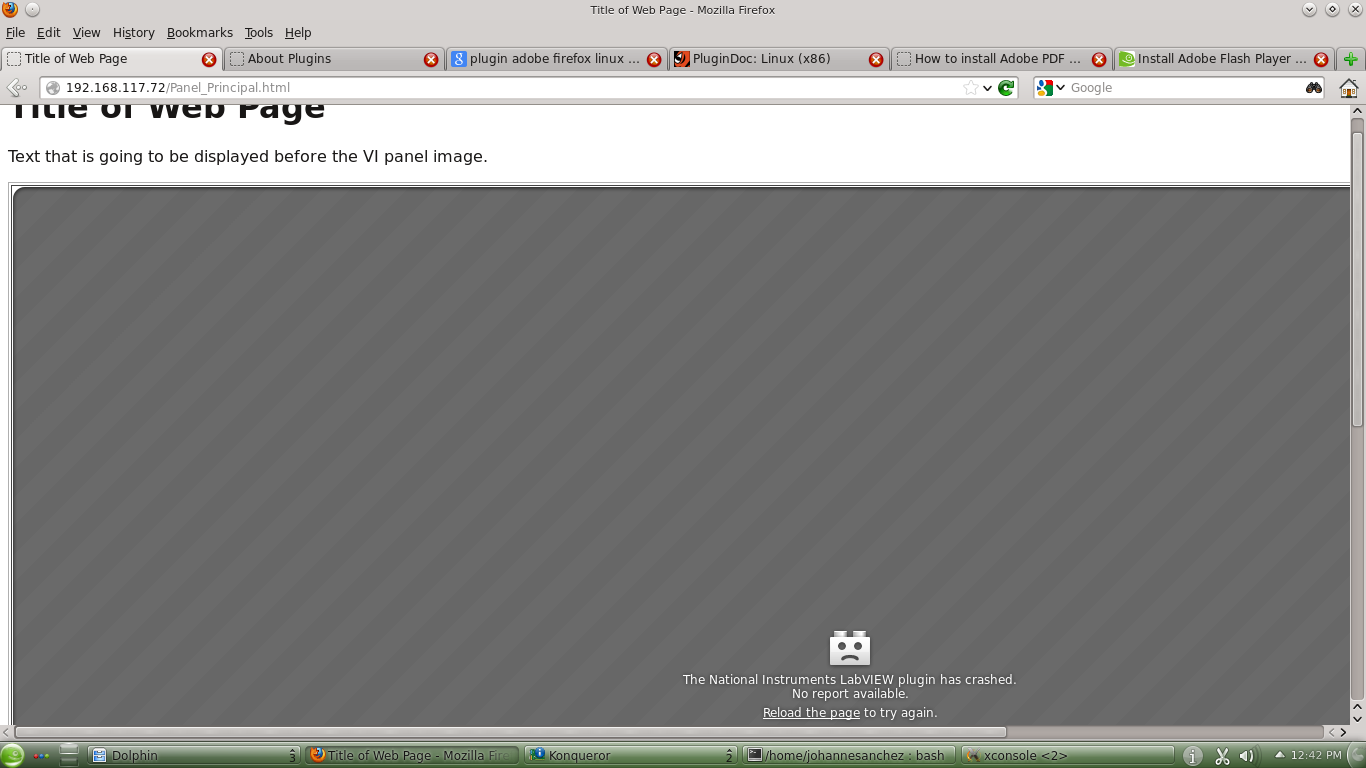

Hi, I am very worried, i am probing my application Labview with Web Publishing Tool, it includes the following:
I have to access to the application from the client with Opensuse 12 that i have installed.
I installed the plugin (RPM) correctly http://joule.ni.com/nidu/cds/view/p/id/2538/lang/es. (I can see the installed plugins in firefox browser through URL about:plugins) and this is ok.
I could not find the folder .mozilla\plugins and usr\lib\firefox\plugins so i had to created them. And i put the LV2011NPlugin.so file there as the recomendations say http://digital.ni.com/public.nsf/allkb/151BE12C055F57CE86257043006CB4B3?OpenDocument#Linux .
When i acces to the application i get this:
Please, Please, Somebody help me. I will really appreciate it.

Hello Tolima,
which version of Labview are you using to create a Remote Front Panel? You should use this version of LV Run-time Engine (2011) to run Remote Front Panels that were built with LabVIEW 2011. So check your versions.

Hi rramos, thanks for replying. I'm using the same version 2011, the software and the web plugin, and I checked the firefox web plugin folder and there is the LVRT2011.so. I dont know what to do.

Hi Tolima,
this looks like a path issue. I suppose you don't need create these directories. If I am not wrong the default directory for Mozilla Firefox on OpenSUSE is /usr/lib/mozilla/plugins.
Try this and return me the results.
