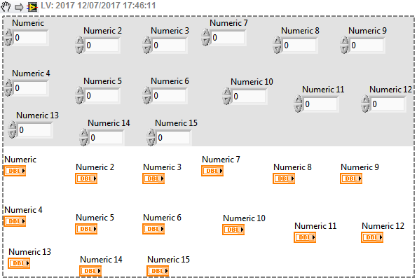

I am having lots of LV crashes. My system is Win7 x64, LabVIEW 2017 32bit installed.
I include a snippet below, please try to play with it, I am interested if you can crash your LV2017 copy too? Of course, save all your work before!!! Just pull the snippet, or recreate something similar. It looks like these crashes are not produced at every distribute objects actions, but at every second/third try roughly...
Steps to try to reproduce LV crash: go to the block diagram, and select all objects. Now try to use the "Vertical centers", or the "Horizontal centers" alignment actions. You might need to go back a few times (Ctrl+z) and repeat.
(Of course these distribute object actions on this particular snippet do not make too much sense, this example only for demonstration) .
Please report back, if you manage to crash your LV dev environment...

I can't drop your image into LV.  Seems like a problem that Jeff has reported. http://forums.ni.com/t5/Feedback-on-NI-Community/Snippets-are-broken/m-p/3659159#M14793
So I quickly created a blank VI and copied in 15 numeric controls.  I did not see a crash with them.

Ok, I try to attach the png as a file. The forum has a new insert photos pop-up tool, it might killing the snippet pngs?
Hmm, it is also good and bad that you cannot reproduce the crashes. It does not happen 100% for me, please try it several times, highlight all objects, and select a distribute tool. If it does not crash it, go back with ctrl+z, and try another tool...

That one I can drop.  I think you solved that problem.
That problem yes 🙂 I think the forum engine destroys the snippet png code content if you use the "drag&drop" option to add your snippet to the forum "insert picture" dialog window (i drag&droped the png file from Total Commander window). It looks like you have to use the "select file" option...
People, keep trying, and crash your LV2017 copy! I will not sleep tonight if we do not see another crash at least! 😄
