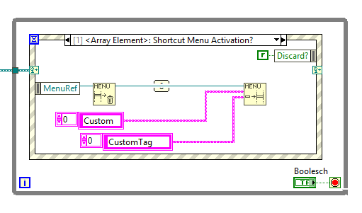

Try inserting a "Delete" Menu Items before the custom menu. It seems to work then.
mcduff
Add delete menu itemsAdd delete menu items

Do you mean like this (see version attached)? It doesn't change anything to me (LV 2015 SP1)
