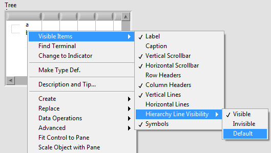

Accepted by BigDrum
There is a setting to show or hide the hierarchy lines on the tree:
I'm not sure what the "Default" setting means...perhaps it uses some system-specific setting to decide whether to show the lines, and that setting is different on your two machines? If you set this value to "Visible" then I'm guessing the problem will be solved.
Message 7 of 11
(3,603 Views)
You are correct. Thank you Darren !
I checked the computers. Both in LabVIEW2009 and 2012, if you create a Tree, the selection is default.
In 2009, show the lines but in 2012 not showing the lines for whatever reason.
